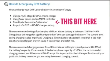

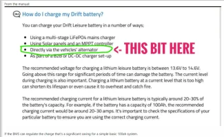

Browsing around Fogstar seem to strongly hint that their batteries can be charged as lead acid at 14.4v - just wondering if anyone has tried that...
From the manual:
If the BMS can regulate the charge that's a significant saving for a simple basic 100ah system.
I'm just a bit suspicious, especially with the wildly varying voltage in smart alternator based system...
well I've played with SLA chargers and lithiums. . .
but i deffo would not connect to a cars alternator. . .
a flat lithium will easily draw 200A from an alternator and smoke it.
victron done some tests . . .
see the video here -->
they cooked it. . . .
I was certainly surprised to see it there in the manual.
Theoretically something like a BMS should be in a position to regulate charge as none of these batteries are really "bare" lithium cells, after all they are capable of talking between themselves to balance things, I've just not seen it done. But if they evolve to be completely drop in it would be the next step.
Might drop Fogstar a line and see what they mean.
But yes I'm not going to experiment directly...

but most battery BMS will allows up to the max current, most are 100-200A on a 100Ah battery. ( most will NOT allow you to regulate the incoming current within the BMS settings - they just use MOSFETS to switch the current flow ON or OFF)
(but some CHARGERS allow to set a current limiter (Victron & Renogy spring to mind))
so a battery pulling 100-200A is way more than most alternators will handle.
the T6 has a 140A or 180A alternator,
running the engine could take +40A alone,
so adding a unregulated lithium will pull max current.
plus a T6 alternator under regen outputs 15.0V which is more that most lithiums can handle - this will trigger the battery BMS over voltage alarm.
and a smart alternator will freewheel at 12.6v most of the time - which again is no good for a lithium and wont charge it.
charge rate and current flow is directly related to the source voltage and circuit resistance. so a direct connection to a T6 Alternator and starter battery is NOT A GOOD IDEA.
so my advice, and many battery makers is to use a DC-DC charger on a vehicle as a buffer between the engine/alternator and any lithium battery bank.
Those are exactly the reasons I was surprised, and to be clear to other readers I'd certainly second the DC-DC advice.
I've dropped Fogstar a line to clarify quite what they mean by that line as the engineer in my head is intrigued.
