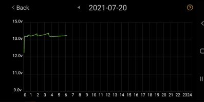

I have posted this on another thread but its the charger discussion one so i thought id do a separate one to see if anyone else has had this with Noco’s or any other charger. I've been camping this weekend. Running a Dometic CRX50 and a Noco Genius 10. The Noco charges when you turn it on/initially plug into hook up and it works through its stages and gets to the top so all lights are light and top green is flashing, once it swaps into optimisation mode and the rest of the lights go off and the top green flashes the charge just tails off and although the fridge is continuing to use power the noco charger doesn't change back into maintenance mode and start the cycle again. Id been keeping an eye on it but it still managed to drop to 12.2/12.3 which isnt great!

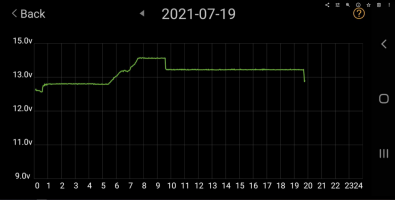

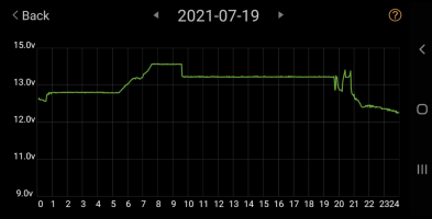

Below are a series of pics from the weekend, im pretty sure on if not all of the occasions before it starts climbing I've had to turn the unit on and off:
937A34D5-9D79-4AB0-B29A-BBFAB89F5226.png8928C46E-F581-4BAD-972E-FFD96D22F5D0.png28DDE641-8DA1-4128-9FDA-30DB099A4D0B.pngB84C0547-E898-48F9-9563-C7AA5A5B3CE2.png
Am i worrying over nothing and give it another go or can i check anything? Van is currently sat outside doing nothing, had a short journey up the street about an hour ago and is running a stirling B2B 120A set up as the below and the and battery monitor shows at 13.02V

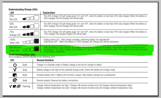

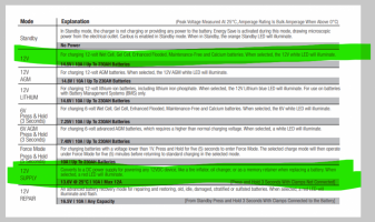

It does say in the instructions that it should change between maintenance and optimisation mode though, it has power supply mode as well but wouldnt this just over charge the battery if left unchecked? The noco’s are recommended by others as a smart charger so it should be able to cope with this, i would have thought9DDC2175-0A6D-4305-B7DD-959B8454A62C.png

I've just sent my Noco10 back but from what I remember the 12v supply needs to be selected with the mode button and I would not use this if still connected to the battery. The fact it doesn't jump back to charging mode when the voltage drops is a poor show tho.
I guess it's just designed for charging batteries to a full state?

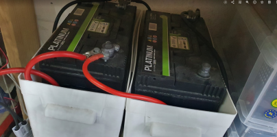

batterys full . .
green LED pulsing . .
load now conected and discharging battery . . .

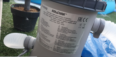

discharging battery at 53w . . . .
lets see what the charger does and when . . . . . . .
battery monitor show 4A draw . . . . and 12hrs to go ( the battery shunt thinks its a 200ah battery bank, but I've disconnected one battery to accelerate the test results)

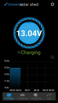

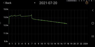

its the following morning . . and the charger looks like its restarted the cycle . . . (on the cctv i set up)
lets see the BM2 readout. . .
looks like in this test the charger restarted at 12.2vish (just bellow you point)
charger has moved back into full charge mode . .
bm2 showing 13.5v . .
and the logging shows. . .a drop over night from the load . .
till about 12:10am . . . at which point the charger re-started again...
ill leave it running today to log more...
so it looks like it was right on the threshold and about to restart. . . ?
ill update later - off to work now.

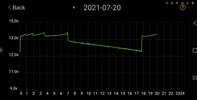

Update . . . just back from work, so around 12hrs later.
the charger was showing in charging stage . . .

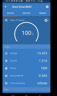

but the BMV712 was showing the battery was draining . . . -1.7A running the pump.
the BM2 plot confirmed that and shows that the battery reached full charge at 7am this morning . . . then dropped its volts as the load drew power from the battery. . .

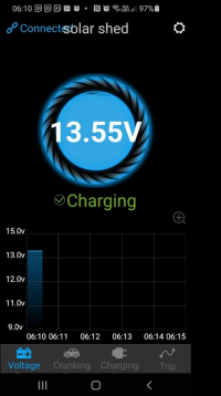

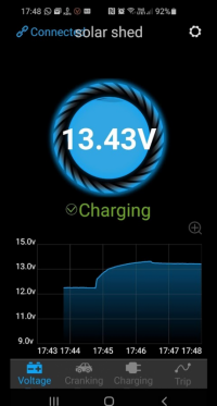

Then in a total fluke moment i noticed the charger lights change out the corner of my eyes. . . while i had the BM2 running.
i was looking at the screen, it was showing 12.25v and slowly dropping . . then it started charging again and jumped up to 13.45v. !!!!! (perfect timing)
so once again the charger has automatically restarted the charge cycle when the battery voltage dropped to about 12.25v.
ill leave it all running for another 24hrs to make sure the results are repeatable.

bit later (couple of hours), its still charging... the meter showing 8A going into battery.
ill get an update in the morning . . .

If a large load gets put on the battery and its voltage drops, the charger will kick back in to top the battery back off. However, you should know the GENIUS10 wasn't meant to charge a battery that has a constant load on it because the charger expects it will be able to get the battery back to full at some point. So potentially if the draw on the charger lasts long enough for the charger to time out, it will display an error and stop applying a charge to the battery. We just do not recommend charging a battery under constant load as it will diminish battery health faster than using the battery, and then recharging it will.

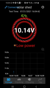

Hold on - day 3 and its all gone wrong.. . . (NOCO 10A Charger )
Im just back from work and come out to check on things - its not good.
The inverter running the pump is bleeping the low battery voltage warning . .
The Bm2 readout shows 10v on the battery . .
looking at the plot we can see what has happened.
The pump has been drawing a 4A load constantly . . The 10A NOCO charger has done a good job keeping the battery recharged (in cycles restarting at 12.25v ish)
Until today that is . .
Its decided that enough is enough and now showing the battery error message and has stopped charging.
It has decided that the battery is faulty and has stopped charging. . . . this is correct as this would be trhe scenario of a faulty battery (ie will charge to full voltage but drop that voltage very quick)
Running the 4A load has similar symptoms of running the battery low very fast. . . . so the NOCO is working as designed.
BUT Not what we want . . . . . . . we want the NOCO to keep charging the battery an NOT time out. . .
Notes: we can switch the charger off/on to restart the cycle . . . this is the easiest way to use this charger for this purpose. . just restart once every 24hrs.
