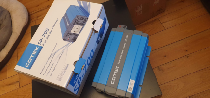

Cotek.
Sp600
Sp1000

1648275247713.png1648275254279.png1648275261477.png1648275269832.png1648275276695.png1648275283025.png
part5 .
Inverter test export doc . .

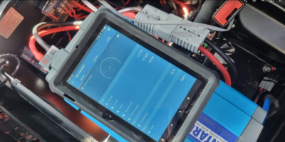

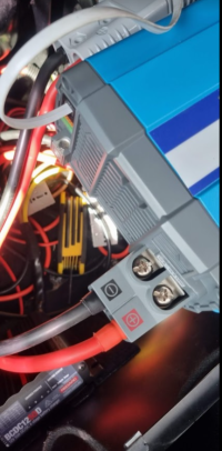

I've started fitting 150a Anderson connectors to my 1000W+ inverters and feed cables. .
to make testing and swapping them over easier. . .

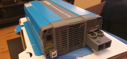

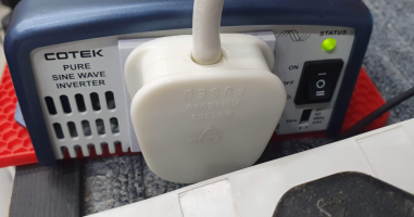

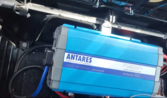

Here we have a Antares (Cotek) 1000w unit.
8mm bolt feed connections. . .

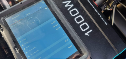

ticking over at 542w its drawing 41.88A
swapping back over to the Renogy 1000W . . .
we can see 770W its drawing 60A . . .

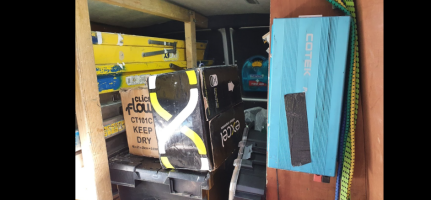

im finding it hard to find an inverter thats 1000w+
that will fit in the bench section.

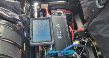

im having issues with some inverters with the surge and they shut down,
evenif the surge is just a blip,
so far the Renogy 1000W is the only one that doesn't complain.

But it's just to big to fit in the double seat base.
I'll be making space in the rear for the larger units........with the 150A Anderson quick disconnect.

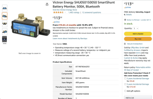

Thanks Lee. Is the only difference between the 712 and this one the round monitor unit? This one, which is also bluetooth enabled apparently does all I need. ….or have I missed something?
No that basically it ... Both are Bluetooth etc.
But the 712 has the remote display and a programable output.
The smart shunt will be fine for you..... Just put it on your leisure battery between the battery NEG post and the neg busbar.

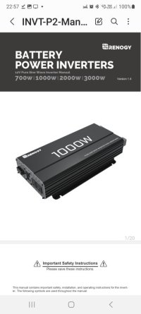

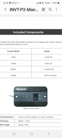

The Renogy 1000w inverter guide shows a 150A supply fuse. And 4awg cable up to 3ft.
So a 150A Midi or maxi fuse might be best.
Suppose they are accounting for the increase in current due to the drop on voltage under load.?
It's also worth noting the Renogy recommend 100Ah worth of lithium battery per 1000w of off inverter.
