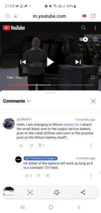

Also I've just watched the following video here on the forum and he seems to suggest connecting the black cable only if you have an AGM ?
Confused dot com lol
This is exactly what I said! Black to +12V for Lithium-ION.
(The video is for CTEK D250SA which has no Lithium profile)

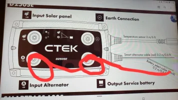

You did thanks I think I am looking at too many things so my next question is can I use either of the power sources on my Ctek to connect the black cable circled in pic attached? or do I need to connect to the leisure battery itself?
Thanks so much for all your help
The black cable is acting as a selector switch so you need to connect it to something permanently live. So that's not the service/leisure battery as that may go very flat, you need to find a source from the van side. If you are taking the feed to the terminal marker "input alternator" directly from the van battery than you could use that, but be very careful not to compromise the integrity of the high current connection. It might be easier/safer to take a permanent live from elsewhere in the van electrics.
If you are not sure this is an area it's worth finding an auto electrician, a lithium battery when shorted can supply an unbelievable amount of current, not something you want happening under the seat you are sitting on or the bottom of your cupboard.
