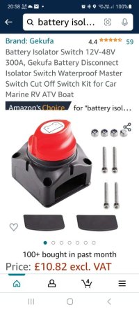

Most people should have a main isolation switch that disconnects the battery completly. (For storage, safety and maintenance purposes)
So.
Lifepo4 battery --> master fuse (eg 100A midi) --> battery isolator --> positive busbar, or fusebox.
Example:
Basically it's not recommended to have loads of wires connected to the battery pos post, you should have one main fused, switched feed that connects to the sub fusebox that runs all your various circuits.
So.
Example:
