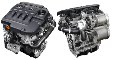

    ea288-engines-designed-for-eu5-and-eu6-don-t-have-defeat-device-volkswagen-confirms-101273_1.jpg
    The reason for this change is "emissions standards" and MPG/fuel economy . . . the clever guys at say VW worked out that if you used the kinetic energy from deceleration/braking to "charge" the battery then you didn't need to waist precious fuel and MPG`s while driving. . . . . the net effect is that the alternator is mostly free-wheeling and only dumps power into the battery when braking.

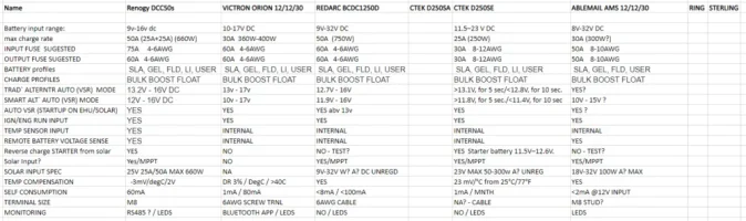

    Next is to look at the available DC-DC chargers and they can/cant do:
    The main contenders are below:
    CTEK
    REDARC
    ABLEMAIL
    VOTRONIC
    there are other makes around.
    The things to look for in a DC-DC or B2b charger are:
    - Max though-put or charging Amps ie 20/30/40/50/60 A.
    - input voltage range ie 10-16V input for start/stop engines.
    - output voltage ie - 12v as some are 24v or even 36V.
    - Battery types they work with ie - AGM, SLA,LIFEPO4, Gell.
    - Multi-stage smart Charging? - most are.
    - Does it have a temp sensor? - some do, some dont.
    - type/size of input/output terminals..
    - Does it have a MPPT solar reg built in? - some do, some dont..
    - can they be parralled up for power users? (some can have 4x in parrallel).
    I personally have been running the Redarc BCDC1240LV,
    and will be upgrading to the BCDC1250D shortly (added Lifepo4 battery + 50A throughput)
    I will also be getting a Victron 12/12/30 to test (to see if it will work with VE-Direct)

    Next we have the New Kit-on-the-block Victron:
    Orion-Tr Smart DC-DC Charger Isolated
    https://www.victronenergy.com/dc-dc-converters/orion-tr smart
    The Orion-Tr Smart DC-DC charger is a professional DC to DC adaptive 3-stage charger with built-in Bluetooth.
    For use in dual battery systems in vehicles or on boats where the (smart) alternator and the start battery are used to charge the service battery. The unit can be monitored and programmed via Bluetooth and can be remotely controlled via a remote on/off switch and has an engine running detection mechanism.
    The Orion Tr-Smart charger can be used in 12V or 24V systems and is suitable for both lead acid and lithium batteries. Models are available up to 400W and unlimited multiple units can be connected in parallel to increase output power.
    Suitable for high temperatures up to 55°C with a full rated output up to 40°C.
    https://www.victronenergy.com/uploa...Smart-DC-DC-chargers-isolated-250-400W-EN.pdf
    NO YT Vids yet !
    Next Up CTEK
    D250SE
    D250SE
    Product information
    Dual input 20A charger with selectable charge voltages
    Enjoy more and relax
    With award winning Swedish technology, the dual input D250SE allows you to enjoy your vehicle more with maximized battery capacity as the ideal charger for vehicles without access to a mains power supply.
    The D250SE is a fully automatic, 5 step charger that supplies up to 20A of power to any 12V lead-acid or lithium* service battery from 40–300Ah. It has selectable charge algorithms for AGM and lithium* batteries and can use power through its dual input from alternator, solar panel and wind power. When the service battery is fully charged, the D250SE will automatically redirect maintenance charge power to the starter battery. The D250SE can maintain a stable output up to 20A to vehicles fitted with smart ECU controlled alternators and also has a temperature sensor for optimised charging, regardless of weather conditions. *) 12V lithium batteries (LiFePO4, Li-Fe, Li-iron, LFP)
      • 20A fully automatic temperature compensated charging for batteries from 40-300Ah while you’re on the move
      • Dual input (solar and alternator in parallel)
      • Smart alternator compatible
      • Selectable lithium* and lead-acid mode
      • Solar panel regulator with Maximum Power Point Tracking (MPPT)
      • *) 12V lithium batteries (LiFePO4, Li-Fe, Li-iron, LFP)
      • Battery separation replacing diodes and VSR relays
      • Selectable AGM option – 14.4V or 14.7V
      • Maximised charging for better battery life and performance
      • Temperature sensor to compensate for hot or cold conditions
      • Splash and dust proof (IP65)
      • Compatible with SMARTPASS 120 for the ultimate 140A power management solution
      • 2-year warranty
    https://www.ctek.com/storage/ma/791...A8900527CCD/D250SE-productsheet-low-UK-EN.pdf
    Ablemail
    AMC12-12-30
    AMC12-12-30 | 0161 745 7697
    This AMC12 charger works on vehicles with a 12V electrical system to charge nominal 12V battery packs. The AMC charger works with Ignition control, Constant Voltage Alternators, Euro 5 & 6 engines, STOP/START, Smart Alternator charging systems & Vehicles with Regenerative Braking, ( Mercedes Benz Blue Efficiency Vehicles, VW Blue Motion Vehicles, Ford ECOnetic vehicles, Vauxhall ecoFlex vehicles to name a few). The unit delivers 30A charging currents to charge upto to 300Ahr battery packs .
    The unit operates with from 9-30V and so works with long cable runs and large swings in input voltages .The unit is protected against current overload and over temperature protection with a fully automatic reset . The software optimises the battery charging cycle and is configured to suit most types of lead acid including Gel, AGM but can easily be reprogrammed to fit a particular type of battery or customer specification using the Ablemail Software Interface (ASI). The optional Interface Card adds remote output voltage monitoring for when the secondary battery is a long way from the charger & Battery Temperature monitoring for operating in extremely hot or cold conditions. The unit can be programmed to charge Lithium batteries .
    The unit is assembled in an aluminium extruded case which can be filled with resin for operation in particularly harsh environments. It can be supplied with a variety of connection options see the Ablemail Mechanical Options. This product is part of a large range & if this product specifcation does not meet your requirement please contact our technical department to see if we can meet your exact needs.
    - Output Load Current:30A.
    - Input Voltage:12V nominal (10-15V).
    - No Load Input Current:2mA @ 12v input.
    - EMC:E11 Approved CE approved.
    - Protection:Automatic overload and over temperature protection with fully automatic reset.
    - Output Voltage:12V.
    - Isolation:Non-isolated.
    - Spec Sheet:
    [​IMG]
    AMC12-12-30E DATA SHEET.pdf
    No YT vid????
    Next we have Votronic
    Charging Converter VCC 1212-50
    VOTRONIC - VCC 1212-50
    Battery-to-Battery (B2B)
    Charging Technology
    Starter Battery Supply Battery
      • The efficient charging converter ensures high charging capacity, already within short distances.
      • Full charging when driving longer distancesIt increases/reduces the voltage to the level, which is required for precise charging of the board battery with the optimum charging characteristic line.
      • Cable losses and considerable voltage fluctuations of the generator, known from Euro 6 vehicles (intelligent alternators), are completely compensated.
      • The charging converters excel by their compact design, low weight (high-frequency switch mode technology) and powerfully dimensioned power components for safe operation.
      • The energy balance of the board battery is considerably improved, without intervention into the starter circuit.
      • The simultaneously supplied 12 V consumer loads are protected against overvoltage and voltage fluctuations.
      • The charging voltage is free from peaks and is controlled in such a way, that overcharging of the batteries is excluded.
      • Fully Automatic Operation: The unit is permanently connected to the batteries, and it is automatically activated by the running generator of the vehicle. Battery discharge in case of an engine stop is avoided.
      • Parallel and Floating Operation: In case of simultaneous consumption, the battery will either continue to be charged or maintained via trickle charging. Calculation and control of the adaptation of the charging times is effected automatically by the unit.
      • Unattended Charging: Multiple protection against overload, overheating, overvoltage, short circuit, incorrect behaviour and back discharge of the battery by electronically controlled gradual reduction down to complete separation of unit and battery.
      • Integrated On-board Mains Suppression Filter: Unproblematic parallel operation of charging sources (EBL, chargers, motor-driven and petrol-driven generators, solar systems) on one battery.
      • Charging Cable Compensation: Automatic compensation of voltage losses on the charging cables.
      • Connection for Battery Temperature Sensor (included in the standard delivery scope): Lead batteries (acid, gel, AGM): In case of low outside temperatures, full charging of the weak battery is improved by automatic adaptation of the charging voltage to the battery temperature, and in case of summery temperatures unnecessary battery gassing will be avoided. LiFePO4 Batteries: Battery protection in case of high temperatures and particularly in case of low temperatures < 0° C. Highly recommended, if the battery temperature might drop below 0 °C during operation.
      • Charging Aid for Deeply Discharged Lead Batteries: Gentle preliminary charging of the (lead-acid, gel, AGM) battery to 8 V, followed by powerful support of the battery, in case of possibly switched-on consumers.
    next we have Sterling.
    Pro Batt Ultra Battery to Battery Chargers, Non Waterproof, (Drip Resistant IP21)
    Sterling's range of Battery to Battery Chargers (B2Bs) has grown significantly over the past few years. This is in an effort to supplement the ever growing demand from the commercial vehicle, recreational vehicle and marine industries. The B2Bs have become extremely popular as they fast charge batteries as you cruise along without the need for complex wiring, touching your alternator, voiding the alternator's warranty and tampering with the electronic control units (ECUs). You can provide the onboard batteries with a fast 4 stage charging profle with a very simple and speedy installation. All of the benefits of advanced charging without any of the drawbacks. Simply connect the B2B between the battery being charged and the battery you wish to charge.
    DC V (In) DC V (Out) Amps In Weight Kg L x W x D mm Part Number
    - 12 12 30 1.2 190 x 160 x 70 BB1230.
    - 12 12 60 1.4 190 x 160 x 95 BB1260.
    - 12 24 70 1.4 190 x 160 x 95 BB122470.
    - 12 36 70 1.4 190 x 160 x 95 BB123670.
    - 12 48 70 1.4 190 x 160 x 95 BB124870.
    - 24 24 35 1.4 190 x 160 x 90 BB242435.
    - 24 12 35 1.4 190 x 160 x 95 BB241235.
    - Remote Control with 10m cable BBURC.
    Features:
    1) Multiple Activation Modes: Automatic for most non vehicle applications,
    Manual for remote activation.
    Regenerative braking (requiring ignition feed),
    Automatic regenerative braking, requiring no ignition feed.
    2) Output charging at 12V, 24V, 36V and 48V. Input voltages at 12V and 24V, Up to 800W rating.
    3) Much larger model up to 3000W coming soon.
    4) Current is NOT taken from the input battery and given to the output battery. The B2B uses alternator power to charge the output battery. Manual mode and regenerative braking mde allows you to override this.
    5) Safety features:
    100% fire proof plastic box.
    No screws to corrode.
    Thermal power reduction.
    Multi stage fan cooling
    6) Night Time Setting: Allows the unit to ran at half the power so the fan noise is kept down.
    7) Boost / Reduce Charging: The B2Bs ensure batteries get the correct charging profile irrespective of high or low input voltages.
    8) B2B turns on at 13.3V and turns off at 13.0V (x 2 for 24V). Thus, does not drain input battery. Regenerative braking mode allows the input voltage to drop to 12.2V (x 2 for 24V).
    9) Customizable Profile: Choose your own charging profile on the front panel.
    10) 9 preset battery chemistry options: Including AGM, LiFePO4, Gel, Flooded and sealed lead acid.
    11) 4 stage battery charging: Thge B2B charges batteries between 5-20 times faster than a stand alone alternator.
    12) Very Simple to install: No electronic Control Unit (ECU) issues. No complex wiring. No warranty issues. Fully prepared for smart alternators (regenerative braking).
    Remote control optional.
    Nemo DX1230 DC-DC charger
    https://www.travelvolts.net/product-page/nemo-dx1230-dc-dc-charger
    The NEMO series DC-DC Charger Converter has maximum two inputs, can draw power from smart alternator or traditional alternator, as well as solar panel, to perform a proper charging for service battery while you are driving. • NEMO is compatible with smart ECU controlled alternator (Euro 6) which delivers a variable output when it is not needed. NEMO could maintain the charging with a stable output in this situation, to assure your battery getting a fully charging in the shortest time. • It will protect or maintain your starter battery even if engine was stopped without issue of starting problems. • Dual input from alternator and solar panel • Compatible with smart alternator – Euro 6 • TBB premium II multiple stages charging algorithm for lead acid battery • Built in automatic temperature and voltage compensated battery charging • Multiple battery chemicals including AGM, GEL, LFP(LiFePO4) etc • Max Power Point Tracking (MPPT) technology • Compact and Water Proof, IP65
    https://www.vigorwebshop.nl/wp-cont...s-DC-DC-Charging-Converter-customer-doc-1.pdf
    no YT vid . . .
    any more you want me to add?

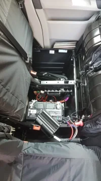

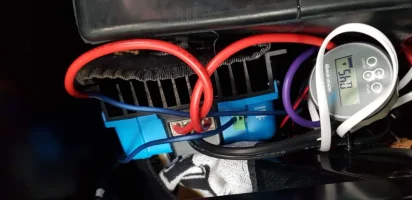

    ive swapped out the Redarc BCDC1240LV and fitted the 12/12/30 so we have a like for like test . . .
    its a bit busy down there , , , , but basically the 12/12/30 is massive compared to the 1240 so i had to temporarily mount it to the side of the battery...
    i made up a loom using 8AWG silicone cables for the power in/out and the Two grounds . . . . Yes Two grounds !!!
    because this unit is "isolated" the in/out ground feeds need there own cable, so i just run both to a ground block . . .
    I also connected the "engine run" 12v trigger to the Remote-H input, this enables/disables the unit.
    here we can see the Bluetooth monitoring . . . voltage in and out . . . i set the battery at a AGM/Gell preset. . . .
