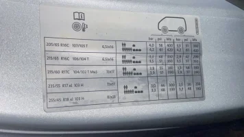

It’s all to do with tyre size, load rating (e.g. 103) and max pressure. In smaller sizes such as 16” to get a sufficient load rating (103) and high enough max pressure the tyre will have been made for the van market (rather than lighter cars) and will be C rated. Larger size tyres (e.g. 18”) will have some designed for larger cars/SUVs and come with a load rating and max pressure capacity high enough for the T6. These will not be C rated, partly because they don’t need to be as the load capacity is high enough and also because there is not the market for these larger tyres in the commercial sector.
If you get a tyre that has a high enough load rating and max pressure the C or XL rating will look after itself. The tyre sticker below (from a T28 panel van) shows how the rating needs change as the tyre gets larger.
