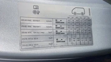

I’m not sure you can readily get 100 rating in that size, it seems to be 99 or 103. Isn’t a 103 just an XL version of a 99 anyhow? I assume there is no demand and/or because the max pressure would still be too low for many applications. My 103s have a max pressure of 51psi and the van can need 48 at max load so not much wiggle room. Strangely a California maxes out at 45psi for the same size tyre but surely it could be just as heavy (or heavier)?? Tyre sticker from my T28 PV conversion:So as in @Pauly post above, you need a minimum load rating of 100. What wheels do you have and what are they rated at??
I’m sure you’re right…. most premium branded tyres in that size seem to be 103 rated which is good. I was just saying that the 100 rating in any size is a minimum for the T28.I’m not sure you can readily get 100 rating in that size, it seems to be 99 or 103. Isn’t a 103 just an XL version of a 99 anyhow? I assume there is no demand and/or because the max pressure would still be too low for many applications. My 103s have a max pressure of 51psi and the van can need 48 at max load so not much wiggle room. Strangely a California maxes out at 45psi for the same size tyre but surely it could be just as heavy (or heavier)?? Tyre sticker from my T28 PV conversion:
I was just saying that the 100 rating in any size is a minimum for the T28.![]()
I ran my avon 255/45/18 at 44psi for 9k and the centres have worn out to 2.5mm with 5mm outside. Clearly over inflated but that's the book pressureI’m not sure you can readily get 100 rating in that size, it seems to be 99 or 103. Isn’t a 103 just an XL version of a 99 anyhow? I assume there is no demand and/or because the max pressure would still be too low for many applications. My 103s have a max pressure of 51psi and the van can need 48 at max load so not much wiggle room. Strangely a California maxes out at 45psi for the same size tyre but surely it could be just as heavy (or heavier)?? Tyre sticker from my T28 PV conversion:
