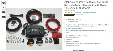

have a look at this kit . .
based around the CTEK D250se
its Lithium suitable and can take solar as well.
add a battery . . . either AGM or Lithium.
add solar at a later date when its sunny. mobile or fixed.
But as you say . . . Victron is awesome, so have a look at the Orion dc-dc.
