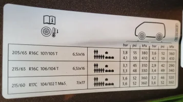

Just bought my T6/T32. Tyres fitted are different to those listed on the door post so wondering what tyre pressure to use?
Door gives 205/65/R16 or 215/65/R16 or 215/60/R16 but the van is fitted with 255/45/R18 tyres. So what to I blow these up to?

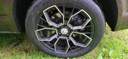

And lastly can anyone identify the wheels?
I run 255/45/R18's at 50psi, previously ran 42psi and got excessive outer and inner shoulder wear
Also some perhaps dumb questions - with the different wheel size will the speedo give the correct MPH and MPG?
They look like Worx Paradox 18"

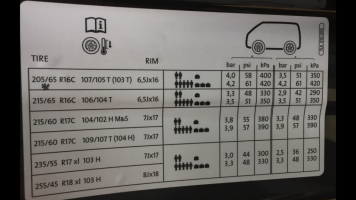

Door sticker off mine with 18” pressures. Mine is a T28 but will give you an idea. My Speedo is spot on with 255/45/18. Try comparing it to the GPS speed on a satnav.
I used to run my 18 sportlines low/mid 40s and tyre wear was pretty even
Thanks people -
I am pretty sure my van is a T32 but the sticker is different to yours;

Sticker from a Cali.
I run sportlines on my T32. 44 front, 41 rear on the unladen setting.
