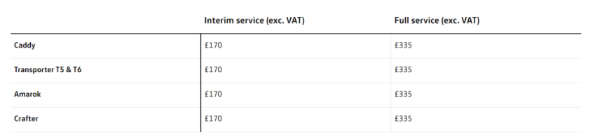

Interim service - £145+vat (oil/filter/Health check) (Price increase 2022 - £170+vat)

Full service - £295+vat (oil/filter/Health check/as per service schedule) (Price increase 2022 - £335+vat)

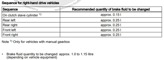

  • Brake fluid - At year 3 and every 2 years after that
