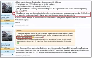

I agree. To complement the list of conditions - another a kind of frustrating one:
Captured from thread ---> I tell you what drives me mad about my T6
Just to recap that unfortunately there are some hidden inconsistencies or even failures. Like the "unstart" @Cherokee described a couple of posts ago above.
