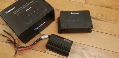

Here it is - the Renogy 50A DC-DC + MPPT. (+LTD +starter reverse charge)
its defiantly bigger than the Redarc and the Victron 12/12/30.....
we currently have the Victron 12/12/30 fitted, next us was the Redarc 1250D . . . . . but now this one?
which one to test next?

So the Renogy DCC50S has a voucher for 5% off on Amazon.co.uk just now so I have sprung for one. Cost £218.49.
Its going to be a while before I get it wired up but be good to work out where it will fit. Hopefully under the passenger seat along with a reasonable battery.

the spec mentions 25A from MPPT and 25A from alternator giving 50A max throughput…
but there is a mention of 50A throughput from alternator only . . . . ?
so please can you clarify these specs.
Is the MAX solar mppt 25A?
is the max alternator 25A or 50A?
what about if I connect any the below panels? . . . what split output will I get?
If the MAX alternator throughput is 50A? and I add 10A worth of solar? . . . will this work out to 10A solar + 40A alternator?
please can you clear up the below and if each line is correct or incorrect
0A solar mppt & 50A alt = 50A total output
5A solar mppt & 45A alt = 50A total output
10A solar mppt & 40A alt = 50A total output
20A solar mppt & 30A alt = 50A total output
25A solar mppt & 25A alt = 50A total output
30A solar mppt & 20A alt = 50A (or will it be limited to 25A solar & 25A alt?)
40A solar mppt & 10A alt = 50A (or will it be limited to 25A solar & 25A alt?)
Many thanks
Here we go . . . . . .
Here is the official word back from Renogy. (I had to read it a couple times before it sunk in)
Hi Dellmassive...
Thank you for contacting Renogy.
The DCC50S will have 50a max current total. 25a from solar and 25a from the starter battery. If you only have 1 x 100w panel at 5a from the panels and alternator running it will still be a 25/25 split or in this case 5a/25a split (30a total). Even if you only have 2a coming from the panels the starter limit will still be 25a.
On their own, the starter battery is capable of sending 50a without solar and likewise the solar with 660w of input can send 50a to the batteries on its own.
If you have any further questions please let us know.
Thank you,
Matthew S. (Tech support)
So basically it 50A or 600w from either solar or alternator as a single....
But.
As soon as you add both you go to 25a/25a split....
A bit confusing at first, I suppose internally there is 2 banks of 25A regulators.....with one power source connected it must feed both banks internally, but as soon as it detects power on both input sources it will split into two banks..... that would explain the readings they are giving....
I still think it's an impressive box.........
Now imagine having TWO of these boxes !!!!!! That would be 50a alternator and 50A solar, giving 100A total...... that's bad boy!
but if you have solar connected you will always get something at the terminals effectively limiting yourself to 25A engine supply, i wonder if it would be worth fitting an isolator on the solar input so if you have flat batteries and need a fast charge (when its not sunny or your solar is nowhere near 600W) you can isolate them to allow the alt to have the full 50A ??
