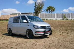

I really like the look of these tyres and I drive off road every week on farms, but I can't think of anything else we intentionally do to our vans that make their braking distances (especially on wet tarmac) and handling worse while increasing the fuel consumption.

I wonder which tyre would be the best balance of this aesthetics vs performance and safety?
I’d previously looked at the labels for a few of the most popular AT tyres and the best I could find was the Cooper Discoverer ATT which has a roll resistance rating of C, and a wet grip rating of C (in a 225/65 R17).
Compare that to the above 245/70 R16 BFG KO2, which have a roll resistance rating of F and a wet grip rating of B (which surprises me).
For some context, the ContiVanContact 100 (205/65 R16) tyres that came on my van have a roll resistance rating of C, and a wet grip rating of B.

I’d like something of that size for the same reason of poor roads (plus I think 235/65 on 17x8ish fills the arches really nicely).
I agree the Falken Wildpeak look really good. I’ve been weighing up my options and considering them in the shortlist.
However, I’m curious as to whether or not a different (non-AT) tyre of the same size would be an equally adequate solution for poor roads, whilst also having better grip and fuel economy. e.g. Nokian Weatherproof SUV (235/65 R17) which is an All-Season tyre with a roll resistance rating of C and a wet grip rating of A, compared to the Falken Wildpeak’s rating of D and C.
