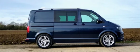

@ .50 - Thanks for the pic, the fit looks great. can you post a side on view? Also how's the speedo accuracy with 265/45/19?
The speedo is out by 1mph now.
When it reads 60mph my gps says I'm doing 61mph.
The next size I will go for will be 275/40r19 which will bring the rolling radius down slightly.
I think 255 wide is perfect for 8.5" rims and 265/275 suit 9".
@.50 -She sits perfect imo. What's your suspension set up?

Its sitting -40mm H&R springs and Koni active dampers.
Wheels are 19"x9" ATS with et48 offset and have 265/45r19 Goodyear Eagle F1 Assymetric 3 on.

You can get away with a 275 on a 9", but unless the 19's are 9.5 wide then a 285 is too wide, Id be going with a 255/45 or 275/40
