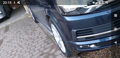

@ .50 - Thanks for the pic, the fit looks great. can you post a side on view? Also how's the speedo accuracy with 265/45/19?
