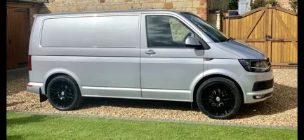

This is B14s and 20s for reference, t30 but had a sag in the rear due to conversion.
Yeh it’s not a slim line pop up roof it’s quite bulky. I’ve been doing a bit of reading up and it sounds like changing the shocks and springs is the way to go. Your set up on that photo looks sweet. I’m just confused about wheel size, 8.5, 9, 9.5,10 etc? I know I want to go with a 275/35/20 tyre to keep the speedo correct and keep in line with vw. Are you running a staggered set up?
