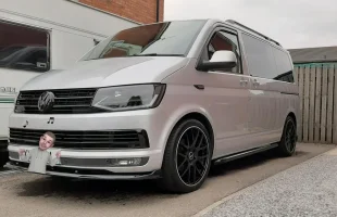

Supermetal Trident 275/35/20 Event Potentem tyres (Budget). Eibach ‘Comfort’ 35 - 40mm adjustable springs. More than acceptable ride quality & quiet (wife hasn’t complained!)

@BognorMotors changed the sizes of my tyres on my LWB T32. I was running 275/40/20’s which came with the van but when fitting B14’s this size rubs. 265/40/20’s are spot on and look great on the wheels and are comfortable. Goodyear Eagle F1 A3’s on mine....
