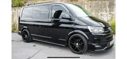

Item eBay number 265212435954
Please can anybody tell me what tyre sizes theses are I can’t make it out from the pics but like how they look I have messaged go explore campers hoping they would be kind enough but no reply 0E76DB1B-2CF7-433D-844A-64A51E064935.webp
I would go with 265 40 20 but it all depends on looks, comfort, price, offset, and load rating. I would go off what Bognor motors recommends. I only went bigger due to the roads and field tracks I go down.so unfortunately needed a large tyre.
