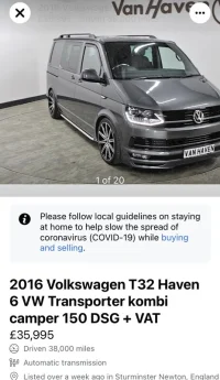

Check this out. T32 with Axe ex15 which I know are 850 kg, not the 860 kg they need to be.
I wonder if anyone has any direct experience of an insurer not paying out due to underrated wheels or tyres, or is it just internet bs? Surely they would have to demonstrate they were being used out of tolerance at the time of the incident.
