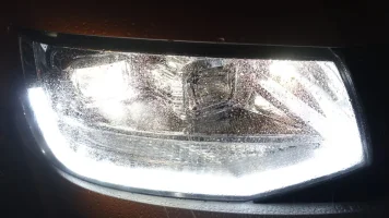

The VW H7 DRL lights are just a bulb swap though, aren’t they?
If the LED strip fails then i'd guess you'd have no DRL on that light. Same would be true of the genuine LED headlight i'd say. The difference is you could probably buy another pair of TransporterHQ lights for less than the price of one genuine LED headlight!
After watching that fitting vid, I dont think i could fit a set of these until i have covered / tidied the wiring up!

I wonder if enabling blink mode with Carista would mean the relevant DRL turns off when indicatingThe indicators aren't the most obvious with those LED DRL's
I don’t see why not - it’s the canbus you’re talking to, not the component.I wonder if enabling blink mode with Carista would mean the relevant DRL turns off when indicating

This can be done with vcds..@KR. I think I read somewhere on this thread or another that for these lights to be fully MOT compliant the dipped beam needed to stay on when the full beam is on.
Depends on how they have wired it I expect but if going from factory H4 to a twin setup using the factory plugs the BCU will need a tweak with vcds or carista(if it does) to keep the low beam feed active when you switch to high beam.I was told that it does it without vcds required! Although I haven’t seen one in the flesh to prove this.
