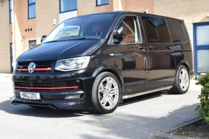

I've read through for a few months now what options there were for new alloys / tyres to fit a T32. My van already came fitted with 20" alloys and cheap Powertrac 275/40/20 tyres as fitted by Leighton Vans and from day one never felt right. I've now fitted 20 x 9" Khan RS600 alloys which I was dubious fitting as I hadn't seen that anyone else had them fitted. Tyres are Goodyear Eagle 265/40/20. For what might seem pretty much a like for like swap the drive has been transformed. I can't believe what a difference its made!
One word of warning for anyone with the 20" Zito alloys supplied by Leightons. When I took mine off they are stamped 815kg max load which is obviously under whats required for a T32. When i've questioned this with them I've been told they must have been stamped wrong and have been given a copy of a Chinese test certificate showing ok to 900kg. I'm not convinced but at the moment haven't taken it any further.

That's a lovely bus dude, but there's no way those wheels have been stamped incorrectly, I'd demand replacements that are correctly stamped.
I agree with @Insert Coin - Leighton are telling lies and there's no way they've been stamped incorrectly. If you 'd had an accident you'd technically be driving an unfit van (possibly breaking the law). Leighton should definitely replace them or issue a refund - fancy fitting cheap Chinese rubbish in the first place!
