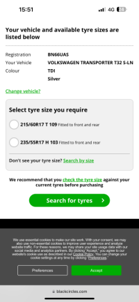

I’ve just gone in to BlackCircle to get a price for the tyres and these - based on the reg - are the suggested tyres.
Perhaps it came with 17” wheels from the factory and therefore perhaps it also have the big breaks?
The plot thickens…
Strange that 16" wheels fit your van if it's a t32 4motion ! Maybe not all t32's come with bigger brakes
It's a common misconception that having a T32 means you have the big brakes. Despite posts to the contrary, the myth still resurfaces from time to time just to confuse the issue.
