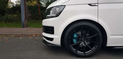

do people recommend staggered 19s or just straight.. and what size? 8.5? 9s? (i presume this is width of alloy? )
Depends on the look you want. I'm running banded Steels 9" front and 9.5" rears giving the rear dish a deeper look than the front, which is what I wanted, but if I was on alloys, I wouldn't see any real point in going staggered on a T6 personally. Just get the offset right and you will achieve the same result using the same size tyres all round. Simplicity.
If I ever went back to alloys, i'd look at 8.5" ET35 all round for my personal preference. Others might have slight variations on this, but it's about the look you want, how low you are etc.

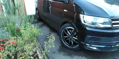

I've settled on a set of Pirelli Scorpion Verde All Season in a 255/50/R19 H 107, originally my wheels were shod with 245/45/R19 H 102 Dunlop.
I may need to get my speedo re calibrated, but let's see what happens once fitted.
My van converters are covering the cost of the replacement tyres and the re-calibration, fair play to them and I think they'll be checking exactly how the wheel sets with tyres arrive in future.
They are lovely wheels though :inlove:
