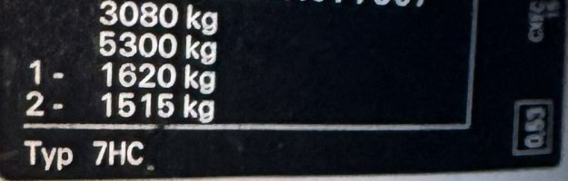

That’s a shame even though the seller has the correct tyres. The tyres have more loads rating than the wheel! Good luck.
I’ve messaged the seller and he’s confirmed the axle load is 1,600kg so no good for a T32 unfortunately. Really helpful seller fwiw. Thanks for your help all.
Interesting, VW quote 1620/1575kg for the California!
It's unusual that an OEM wheel won't cover all models but, as you said, maybe that's why it's not an option on Transporters.
