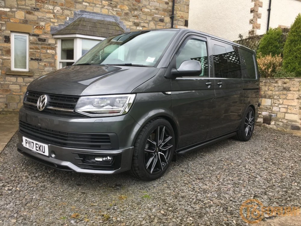

Hi, I recently put T311Rs on our van. I've got 9.0 ET35 front, 9.5 ET40 rear with 265/40/20s all the way round. Van is lowered 40mm and in that config I get no rubbing.
Have added few photos so you can see what they look like. I think the rear setup is spot on but I wish the fronts were tucked under the arch a bit more. With ET35 the tyre is just outside the arch as you can just see in the photos. I think ET 40 on the front would have looked better as it would pull the wheel under the arch a bit more, but don't know if that would cause rubbing
20180526_150828.webp20180526_150837.webp 20180811_135157.webp 20180811_135218.webp
View attachment 26758View attachment 26759 View attachment 26760 View attachment 26761

265/40 is by far the better T32 tyre. Nearer to the perfect size, don’t rub when slammed on Bilsteins with the correct ET and IMHO look far better when fitted. The 275/40 can look a bit too ‘balloony’

We’ve found Et40 is the best offset on a 20. Sorry no pics to hand (I’m camping in southern France at present) but look on our Facebook page. Our old white demo kombi had this setup
