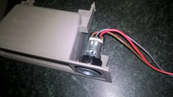

How does this cigarette lighter come out. Have tried pushing in the top and bottom tabs and the ain't moving...... Help!
Found this digging around the net..... a puller tool looks a bit extreme to me for a cigarette lighter.
Got the lighter out, no damage to the tray or the lighter socket. Sadly the mount ring didn't make it. But breaking the mount ring was there cheaper option. Have ordered a luminated one £4.80 yet another mod... lol
Is that something to do with you mullering it, the photos you show looked like you had a go before you took them ;)
Yer had ago first before pics were taken. But it doesn't lock in where you think it does. Pushing the tabs in will only indent the lighter socket. The socket locks in at the middle of the socket.
Luminated socket mount fitted tonight. Power to USB sockets done... Saturday it will all be complete.
@BiTurbo where did you get the feed for the luminated socket .
It's already there fella, three wires in the cigarette socket plug. Red-live, Brown -earth, grey -dash lumination.
