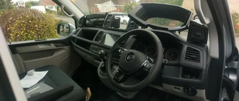

It was a squeeze but it fits. Here proof.

Not so sure that its a perfect fit though buddy, seems to have compromised the view out the screen a wee bit. Is that the VW version of a 'head up display'?

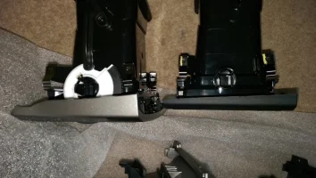

These are the vents and bezel that need trimming .
In the photos I have put the parts together so you can see what needs trimming .
I used masking tape to mark the parts
I used dremel with a cutting wheel ,on a slow speed to stop it melting the paint ,the a sanding block to finish them off
The bezel is the hard one as it needs a gentle curve trimming .
I tried the coloured parts up to the existing parts and you can see what needs trimming.
Hope this helps
Hope this helps

Be careful, I haven't trimmed down the passenger vent as it needs to lineup with the glovebox
I have trimmed some off passenger vent ,as it sat too high ,and didn't line right at the top ,it is flush with glove box top now .
