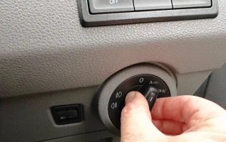

The light switch can be removed by turning to 0, pressing it in and then turning clockwise one position, it will then slide out revealing a screw which needs to be removed, also remove the switch:
