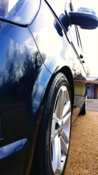

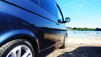

245/45s are fine and comfortable, I've also ran 245/40s but I was lowered 100mm on solows at the time

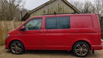

245 45 19 on mine. 3E760A64-F8F1-4822-A9AE-CAD99C25EBCD.webp61FBA401-D995-4EB6-99F5-B7979213DCB1.webp

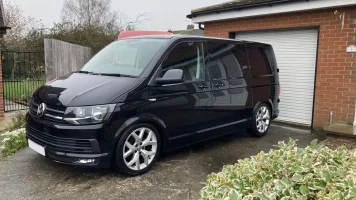

I run 245/45/19 on mine and only ever buy budget brands of tyres as I'm no speed merchant. If I go too fast round a corner I tip over everything in the fridge!
