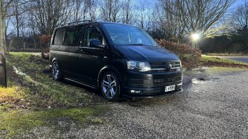

@t6blo .. hope you dont mind me asking but any idea of your 'actual' drop there from std,....?? looks amazing and just the stance i'm looking for ..
I was planning on buying So Low NSL and have them set about 70mm, are you more than that ?
Of course not. We love to talk about our vans on here so ask away :thumbsup:
I have STX coilovers fitted and rear adjuster deletes. It is probably about 70-75mm.
If I was buying them again I would buy SoLow NSL instead.
To get the STX this low I am running the front on their max drop and have had to mess about with the rear by removing the adjusters. The van drives well but I am told the front would perform much better if it wasn’t max’d out and obviously the rear springs wouldn’t flop about when jacking up the van.
The NSL range is 70-95 so I could comfortably go to 80-85 without maxing it out or messing around. If you had them at 70 then they are probably very comfy.

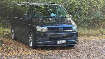

Finally got the wheels cleaned and out of the house before imminent death. A few tiny marks here and there but I think they look great and all factory finish.
So here’s my concern. I’ve already bought a set of So Low NSL’s and planned on having them set on their highest setting. Some say that’s a 65mm drop, others 70mm, as per the manufacturers specification.
Second part of the equation, the wheels are now shod with new Pirelli 255/45 104 XL and the rears will be sat on 15mm spacers. Van is a T30 Kombi so I probably could of dropped to 245/102’s I guess ?

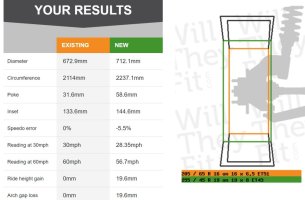

My main concern is that my wheel/tyre choice (255) is oversized for my proposed 70mm drop.. They look massive (height) when placed against the original Claytons. I’m now thinking I should of gone with the 245’s which will have a rolling radius closer to OEM and no doubt look a lower profile. I guess they will be as a percentage of the tyre width.
What about the 5.5% speedo inaccuracy over the original Claytons (205/65/16’s).

I have this size tyre and it puts the Speedo at almost exactly the same as a GPS app readout (spot on at 30, 1 mph under at 70) so that should be ok, you have just lost all your safety margin when going through cameras. This is verses a free iPhone gps app and I guess the error in the Speedo can be different.
Having had 16” wheels on over winter I think it is a noticeable challenge to the gearing with bigger wheels/tyres though, it’s ok but I think it was happier with the std sized tyres. (102bhp manual)
