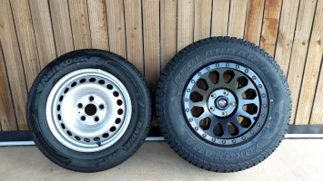

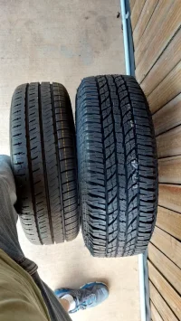

I just got some 'Yokohama Geolander A/T GO15' fitted.
First impression is that they are quieter than the stock Hankook commercial tyres I had on before. Or maybe it's just a lower tone that isn't as annoying and obvious.
These were recommended by the tyre store, so I searched the reviews on them and they are rated pretty well.
