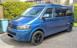

After some issues with the powder coating, finally collected, washed, sealed and fitted yesterday. Double checked pressures at a garage machine this morning, I've gone for 49 PSI front and 47 PSI rear but they still look pretty flat and the ride is quite soft compared to stock 215/60R17s. Standard wheel bolts reused. Quite happy with the Manaus alloys and glad I got them powder coated black.
Tyres still look a bit flat to me and the ride is quite soft. Do my tyre pressures sound correct at 49 (front) and 47 (rear) PSI considering full camper conversion?

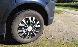

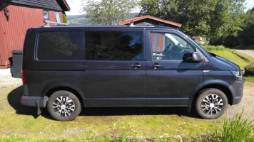

Nokian Rotiiva AT 215/65R16 102T XL on stock steel rims. Had this set of my previous car so i decided to try them on the van. Went straight from nordic winter tires to these, so I can't compare to regular summer tires. First impressions are good, they handle well on tarmac and gravel, and are more comfortable than the 107 rated 205/65R16C tyres. Looks a little rougher than standard tires, but most people will probably not notice. I'll keep an eye out for some 17" alloys so i can go up in size a little when these are worn out.

I've double and triple checked the pressures as set by the garage machine, seemed to be 3-4PSI under all round. Now up to correct pressures and they look more inflated, ride better and MPG is back up to near normal levels for the old tyres.
