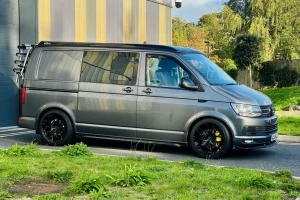

Any photos dude?
Rear Michelin CC3 265/40/20 10J ET38
Front Michelin CC3 Sport 245/45/20 8.5J ET45 with 10mm Spacers
flush with the arches, 70mm lowered (Eibach Pro-Street Coilover), CRS
Driving 38-40PSI, no rubbing.
Tyres are a bit louder than the CC2, good grip, have only done 2000 miles so can't judge really.

Awesome ride 👌 Did you need different bolts to use with the 10mm spacers on the front?
Think I'll be dropping mine from 40mm to 70mm based on this!

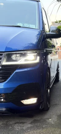

Have you go any pics per chance?
Its probably not going to show you what you want to see as its not the right angle , they haven't been on too long and the weather has been pants so the van has been ditched since.
I went from 275>245 and it was much better, no scrubbing and felt nicer on the road. When I went from 8.5>9 it was barely noticeable tyres look right rather than slab sided but I dont care much for stance/poke/tuck etc so can't tell you in any more detail than that
