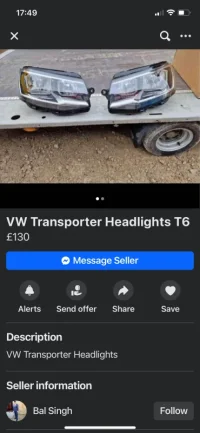

As I said, widen your search wording to pick up poorly titled adverts. It took me 30 secs to find a pair in Sutton Coldfield for £130. There are others too.

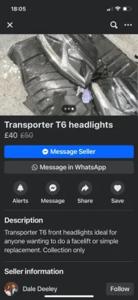

Guy confirmed NOT h7, search continues!!
I’m pretty sure they are H7. The side light is inside the dipped bulb. The main beam lens is not dimpled. Possibly a good example of someone who doesn’t know what they have and the worth of it. Get them to send you a pic of the label.
