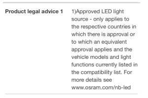

Osram has these bulbs listed as street legal led replacements. Looking at product details of H4’s they state this:
Looking at www.osram.com/nb-led it does not list UK as having approval
There is no UK approval. LED or HID bulbs cannot be fitted in existing halogen headlights and will be an MOT failure. You may get lucky and pass but that is just the tester doing a crap job! Quote from MOT regs:
Existing halogen headlamp units on vehicles first used on or after 1 April 1986 must not be converted to be used with high intensity discharge (HID) or light emitting diode (LED) bulbs. If such a conversion has been done, you must fail the headlamp for light source and lamp not compatible.
This does not refer to complete replacement headlamp units which may be constructed with HID or LED light sources.

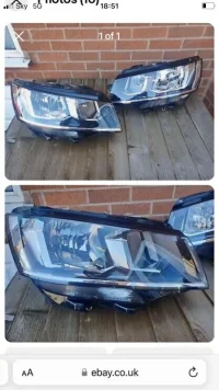

Any way of telling whether these are correct? Found on FB marketplace local to me but cannot fathom if correct (eg not ‘melty’ or even H4/ t6.1 etc?
