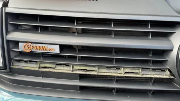

A bit of greenery to remove:

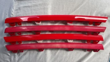

Old vrs new:
An easy 5 minute job.
Took longer to get the bucket of soapy water & hosepipe ready, than to detrim & refit :D
Good to go now, for another 4 years.

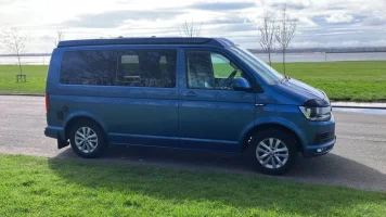

Removed the solar panel from the roof - used a 20mm blind grommet where the cable went through and 4x of the roof rail rubber washer bolts with nylock nuts on the ends inside.
When I fitted it I applied vinyl wrap where the brackets touched the roof and so the sikaflex was attached to the vinyl not the actual roof - meaning they came off cleanly.
Need to wash the roof now but you can hardly see the bolts/grommet from the ground.
Solar panel in the for sale section.
