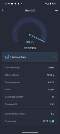

Answered my own question... you just plug it in between the connector and the switch, nothing else needed@RedUn Do you just need to plug this in as you've done in the pic, or do you need to set it up somehow? Mine has arrived today but there were no instructions with it.

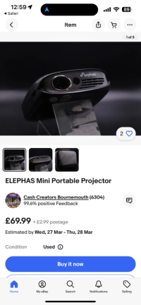

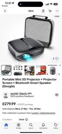

@dcpen43 . How's that projector please? I ask as although I couldn't turn that exact model up on a [very] quick google, those that I did see from the same firm looked a bit too cheap to be true. That said, I also know that there can be bargains out there if you're realistic about your expectations / demands and it's only for the van in my case. Cheers.Cannot recommend this projector Z mount enough. Big dial screw to connect to the projector and it folds up out if the way.
Velcroed my amazon prime stick to the projector with both it and the projector fed via micro USB to USBs
@Ajay10@dcpen43 . How's that projector please? I ask as although I couldn't turn that exact model up on a [very] quick google, those that I did see from the same firm looked a bit too cheap to be true. That said, I also know that there can be bargains out there if you're realistic about your expectations / demands and it's only for the van in my case. Cheers.
