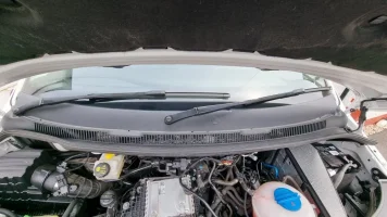

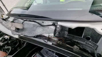

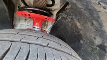

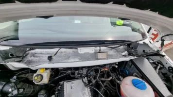

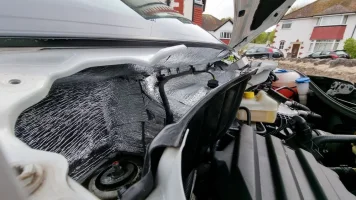

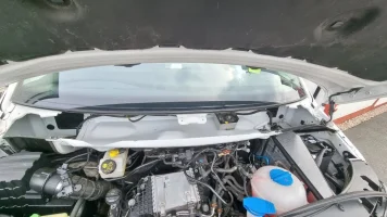

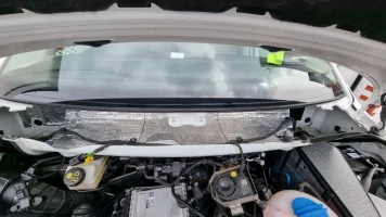

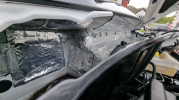

Well there was nothing in work today so thought I would don't own. I have sound deadened the inner arches and the arch liners. Also when I got home I did the scuttle. With more blood this time lol. Swmbo has band me from sound deadening and Stanley knives. . 20220430_121830.jpg20220430_121819.jpg20220430_124947.jpg20220430_125005.jpg20220430_132410.jpg20220430_132416.jpg20220430_132429.jpg20220430_133127.jpg
Yeah probably one of the easiest ones to remove. 13mm wiper nuts, arms off then it just pulls away from bottom of screen. Remove the wiper mech to make it easier. Just 3 10mm bolts also a 10mm for the alarm that's it.
Well there was nothing in work today so thought I would don't own. I have sound deadened the inner arches and the arch liners. Also when I got home I did the scuttle. With more blood this time lol. Swmbo has band me from sound deadening and Stanley knives. . View attachment 155020View attachment 155021View attachment 155022View attachment 155023View attachment 155024View attachment 155025View attachment 155026View attachment 155027
Any comments on road noise after? What materials did you use too? Think this is top of my list now
I had completely sound deadend my vivaro so was used to a very quiet van. Then bought this T6. Noisy wasn't the word. I did the front doors last weekend which made a difference. Doing these today has taken more noise away. I can talk in the van again at the normal level and hear the wife talking (not always a good thing).
I used silent coat and dodo mat insulation foam.
On a side note to all T6 owners. If you remove the arch liner, just above the brake pipe on both sides there were rust patches. Mine was surface but 2inch x 1inch. I wire wheeled it and primed it before putting sound deadener over it.
