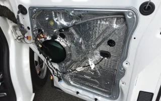

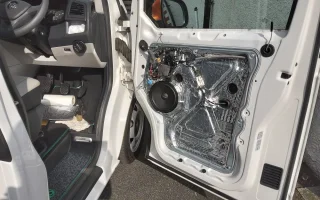

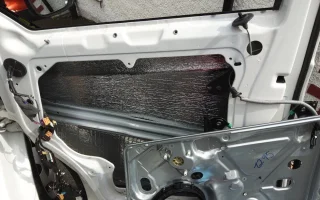

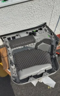

I decided to fit my new Alpines in the front. Stripped down completely used silent coat and dodomat foam in the inside, then silent coat on the regulator plate. Followed by dodomat acoustic foam on the back of the door cards. Speakers were very easy to fit and sound awesome. Now have many cuts all over hands plus two big slashes from the silent coat.

Great job! How much has that cost you in acoustic materials (rather than blood and speakers) to do please?

The silent coat was £65 from Amazon for 40 sheets (doing other doors with it too) the dodomat liner cost £40 for 3m roll and £20 for the accoustic foam. Most likely need more at some point. I am doing the scuttle next.
