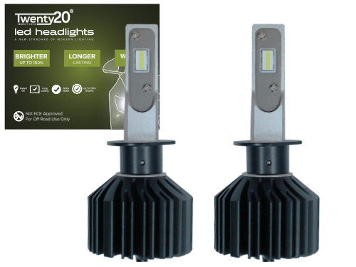

I fitted Twenty20 H1 LEDs in mine. I'd already coded out every single bulb warning during my trials with the lights, so they just worked... for me.
@dubber36 Does the locator ring on the bulb remove on these for easier fitting? I know some led bulbs you remove the locator ring, fit the spring into place and then fit the bulb
Yes, that needs fitting first. Even then it's virtually impossible to fit them with the headlights in situ. I tried mine, gave up, then fitted them with the headlights removed when I did the grille swap for the Lazer lights.

@dubber36 Im fitting the Twenty20 H1 bulbs into the main beam of my V2 lights and at the back of the lense where the bulb locates is a slot oriented at 4 & 10 o’clock. Once the LED bulb is through the slot it cannot be rotated. The bulb is fixed. Is this correct?
Most have them at 12 & 6 o' clock position.
I'm sure with mine, I fitted the collars, then the bulbs just pushed into them and were free to rotate.
@dubber36. No on the H7 HID bulb that is how they are orientated at 12 & 6 o’clock. There is no other way on them to locate them. But on the H1 LED I’ve removed the collar and fitted that but the bulb can only go through a slot that is in the lens so they can’t be rotated. It’s how the standard bulbs were oriented too at 4 & 10 o clock. As you can see there is no way to rotate the H1 LED bulb 36FBC958-66AB-4250-96F4-37D1925DDA0D.jpeg
