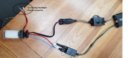

I was getting confused with my old custom T4 twin headlight setup and the plugs I used for those.
So just to confirm....
Darn, just connected up and lost the dip beams all together, high still works as does the drl.
I connected the Black wire from the hid to the to black of the headlight supply, then and blue to red
Guessing its a fuse but I cant find it.
My van is a 2016 Euro 5 highline, 102PS.
Any ideas as I am now at a total loss and without night transport, HHHEEELLLLPPPP
Try switching the black and red round. Might be that and not a fuse.
