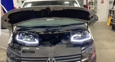

I spoke to the guys at THQ about their current range of headlights. They're really helpful guys and said they're currently testing a version 3. They sent me a video and they look great. LED lightbar with dynamic indicators looking to be available in Jan 2020.
Hopefully they will provide LED bulbs (for off road use) and how to install them correctly. The video shows no errors on the standard set up.
They sent the video on instagram so I can't download it. Here is a screenshot of how they look:
These will look really good, but probably have the same cheepo projectors, meaning HIDs will be the only way of getting meaningful light from them.
That's not a good look! :eek:
I hope that's an unfortunate reflection or they're pre-production units. Assuming the final ones don't look as bad as that, what's the difference over the Version 2 lights?
I think thats a bad reflection on the n/s headlight. I've got the v2 and looks to me like the drl is a strip on the v3 not individual leds like the v2. If you zoom in you'l see what i mean.
I've seen these for the T5.1
The DRL flashes/sweeps orange when indicating.
More money...:whistle: anyone wanna buy a set of thq v2 headlights with osram nightbreaker lazers?.....:D:D
I thought the V2 had "dynamic indicators" already? The T5.1 ones on their IG page look awful though, very cheap looking and you can barely tell they're moving
