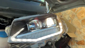

I then connected light and tested View attachment 40083
Installed the light to the van, oh there are 2 x washers supplied taped to the light top on 1 x light only, this is an extra sent from HQ to install with this screw fixing, I didn't find this until the very last minute of the day.
And there you have it light installed
