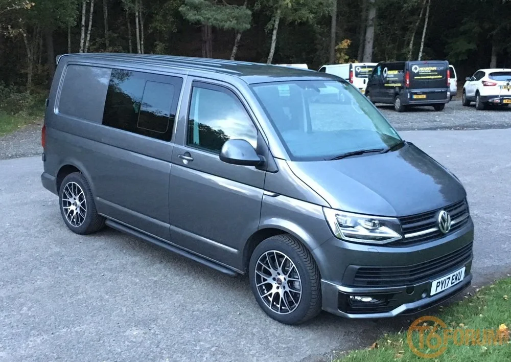

I’ve been eyeing these bbs xa for a while now .
I’ve read a few conflicting opinions on websites about these being suitable .
Where did you buy from Dave?
Rimstyle claim they fit with 275 tyres . No issue with your 265?
What’s the et45?? 8.5 wide or 9.5

They were supplied by New Wave Conversions, who got them directly from BBS UK, so no fitting issues (and they're deffo rate for my T32). I went with 265 tyres as recommended by Oli from @BognorMotors because they use them and they look right for the rims (I didn't want big looking tyres). Even New Wave questioned the sizing but they checked with BBS and they confirmed suitability. I'm not sure on the width but they are ET45 and there are no issues with turning so far - even on full lock. They're on B14's too and dropped pretty low - again no issues.
They look good in pics, but absolutely mint in the flesh!

Those BBS XA look fantastic - So much so I have a set waiting to go on our new 2.0TSI when it arrives soon.
Glad you’re happy with the tyre size. - They work perfectly dont they?
Yeah, they're beauty's Oli thanks and the tyres are the perfect size (not balloons!). I was wondering what pressure you'd run them at?
