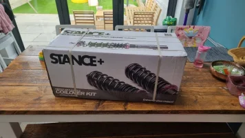

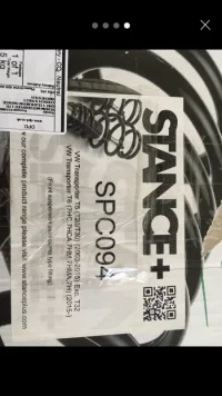

I can't find my order, it was back in Nov, but I have a pic of box. IMG_20201218_130529_Bokeh__01.webp
If that helps?? They went on a 2017 T28.
Stance did a 1st generation kit I call it, it only went down about 70mm max, I removed these and purchased the newer kit that states can go down to approx 110mm. This is my box if it helps. Fitted on my t5.1 14 plate.
