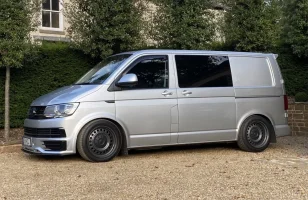

Many others run the SoLows, but I can’t comment on them as I’ve never had them…. what I can comment on is the H&R coilovers. I had the H&R coilovers fitted by @CRS Performance (who aren’t a million miles from you) in October 2020 and this is honestly some of the best money I’ve invested in my van. Steve @CRS Performance is a suspension specialist and I don’t really need to say anymore than that! It all depends on what you want and how low is going to be right and practical for you? Just to give you an example, my van in this picture is on banded Amarok’s with 255/45/18 tyres and lowered by 80mm.
I never have a problem with anything rubbing or catching, speed bumps, etc etc. The only thing I have to be careful of is my Sportline spoiler and splitter.
I know it’s not as low as SoLows, but it works for me!

Hey mate, tidy van!
do you know if you can lower it any more on this setup? If so, do you know how much more? Thanks
Hey mate, tidy van!
Hey @Tyler846 …. Thanks mate!:thumbsup:
I believe it can be lowered to around 100mm, but in order to get it that low I’m sure I’m right in saying it would need additional mods. The best person to ask would be Chris @The Van Cave as I know he was running this setup with the extra mods on his demo van before he went to the SoLows. Other than that Steve @CRS Performance is the suspension guru that fits this kit day in day out. Hope that helps fella :)
