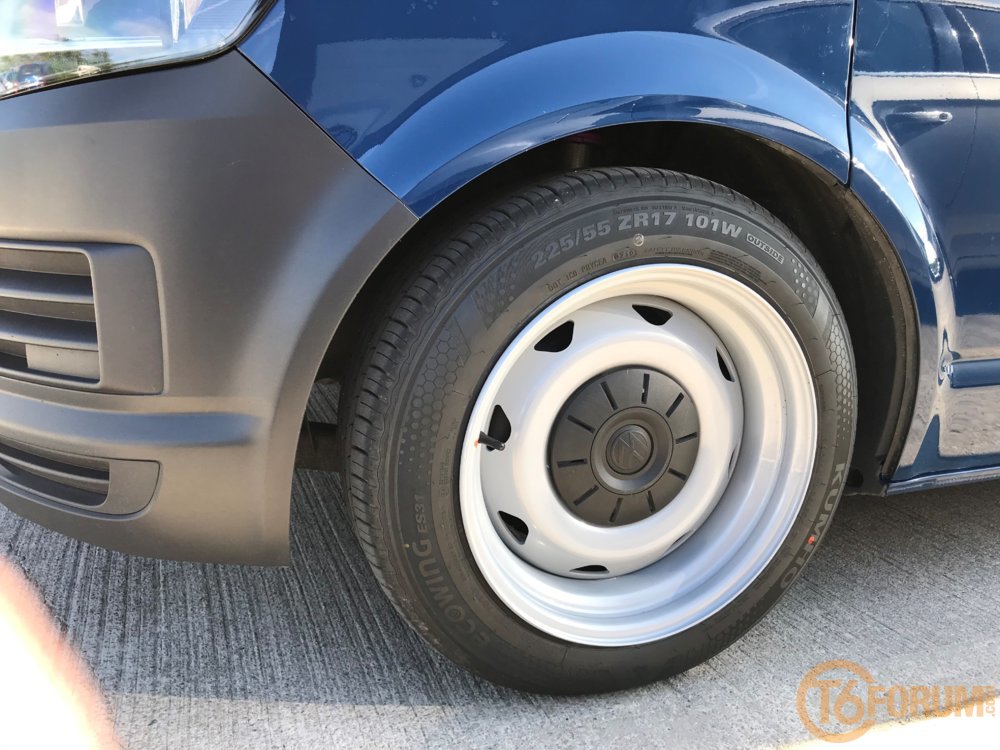

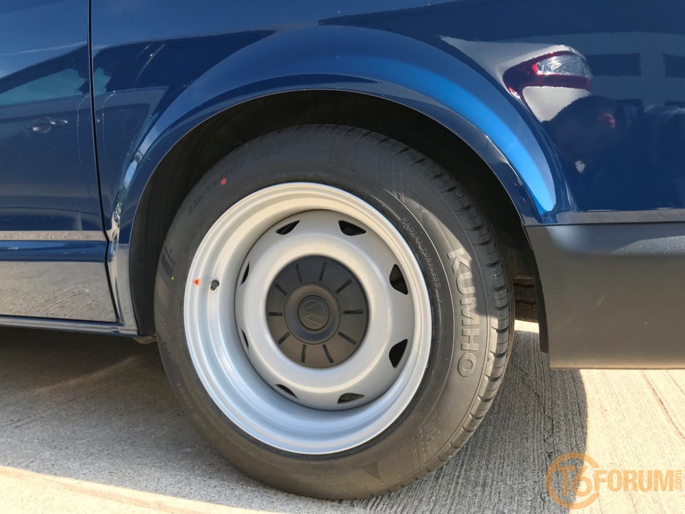

Iv just recently started my T6 Project and was quite keen to sort out those nasty gaps in the wheel arches so bought some stance coilovers to try out.
They are advertised as Front Lowering: 30-65mm and Rear Lowering: 30-75mm
I haven't had time to do them so left it in the hands of the garage. As you can see from pictures the wheel arch gaps are still there. They said its on the lowest setting on the rear but i still have a lot left on the front and as advertised the rear should be able to go lower than the front so im a little confused as to why the rear is so high.
any help much appreciated.
I cant see the back fully.....
But doesn't the front look about half way.... with more drop to go?

can you take pictures of both sides on the rear

From looking at the rear close I recon the rears arnt full wound up and there 5-10 thread left on there
Cheers for the quick reply's. my thought are the same, fronts have got loads to go down and rears have none. checked to see if there are any threads above on rears and its max. still confused why its so high.
heres the pics you asked for, noticed too the little washer has slipped.
