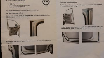

Basically I found the passenger seal should go on the first step, and the drivers seal on the second step.
I think there was a set of instructions somewhere in the thread.

I bought travelin lite ones, very good but there is a right way round and a wrong way round to fit them as they have a specific profile - the instructions explain which way round to fit them. The drivers door is easier to close if the window is open so I think the air pressure in the cab does affect things.
I’ve ripped mine off now , looking at their instructions compared to the instruction posted by trevorK they are different. I followed Travelinlite instructions to a T, and the seal Is hitting a part of the body work it shouldn’t. The instructions above place them differently, which wouldn’t hit the area causing the issue.
As a suggestion….for Those looking to add the additional door seal… if you have the opportunity to visit a dealer …take a look at the showroom models ( not panel/Kombi vans) and you can see the correct fitting of the seal…i too was confused by different instructions provided by suppliers….unfortunately some suppliers just want your money and After buying a second seal which was different in size and suppleness to the original was finally able to shut the door with that….Sounds like a Golf :)

it was from EBay….just checked wife’s eBay history (feb 2019 ) but the seller Is delisted….but I was so anal I measured the depth and width of the seal on the Ocean/beach to get an exact match ..you will find some are 12/14/16mm deep.. ok just check mine it’s 14mm deep…hope that helps :thumbsup:
