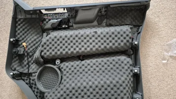

After researching genuine VAG LEDs to use for the door pockets and handles I got Robin at rocketwires to make up all the looms to my design, he was very helpful and all top quality.

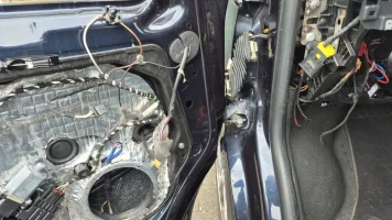

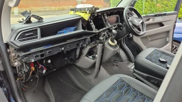

Then came running all the wires. My van was in at @BognorMotors for my seat retrim so they kindly added the pins into the BCM which I’m glad as it looked a pain. I then stripped the dash and ran the looms across, then into the doors with disconnection plugs before the door and also after so that the doorcard can be removed with a single plug.

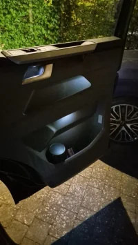

Now my footwell and door lights come on with door unlock regardless of whether the lights are on, door opening and also key out.

Overall it was a fiddly job to have all the looms made, run across the dash and also into the doors and cutting holes but I enjoyed it.
